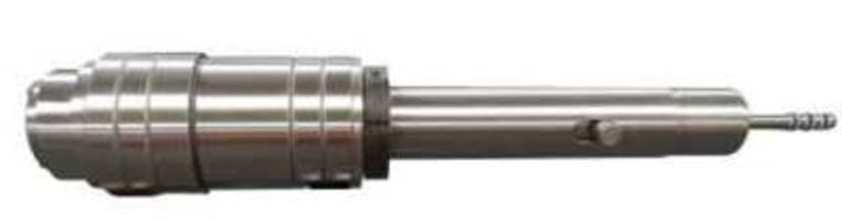

Do you find it strange that is was hanging up when in the machine but spins freely now that it is out?
When moving it by hand in the machine, you couldn't overcome the interference of the set screw hitting the casting. The spindle motor is 17 hp and just ripped right past that. This is assuming you had a set screw (balance weight) come loose. A distinct possibility...

Here is the Spindle Head from the parts list at the back of the Installation manual that comes with each machine. Item 39 is the access plate to the coupling. Need to lower Z down some to access it. Item #2 is the coupling. The small holes (6 equally spaced) around the circumference are the threaded holes for the 'weights'.
Thanks, Frank! So in order for me to test the "weight (screw) came loose" theory should I be able to lower Z as needed, take the access cover off, and look at the heads of the weights (screws) to see if any of the heads are worn down?

My experience is with a 16k spindle but I assume the 10k is also balanced after installation. The procedure is once the spindle is installed all weights are removed before the first balancing run to determine where it needs weights added. Then add the weights, run the balance routine, and repeat until it is balanced. Then pull each screw/weight out, apply thread lock, and install. If you pull the access plate off the head you probably won't see what you are looking for. The most would be a mark on the coupling but I doubt there will be one, only on the head of the screw that was removed and tossed, if that is what the problem was. When the BBT upgrade was installed in my new machine I watched it all, plus read all information I could get on the subject.
So is there an easy way for me to determine if the spindle is fine or do I need to send it out to someone to inspect so they can tell me if it is fine? Since it was hanging up in the machine and not now, is that a pretty strong case that the spindle is fine? Should I ask Yamazen to try reinstalling the old one and if it works ask for my money back on the new spindle and just pay for labor? What a waste to pay 6G's for a potentially loose set screw haha!
In my shop I would consider that spindle good but it depends on how much you want to spend finding out, either by trying it when needed or sending it to a shop for inspection. I am guessing it would cost around $300- $500 to have it inspected. As for Yamazen they did say they don't diagnose spindle issues, they just replace them, which you agreed to. It may be overkill but it does guarantee it is fixed. Kudos to BROTHERFRANK for saying what he thinks could have been the problem, that will certainly stick in my memory, even though I have a smaller coupling so more clearance.
