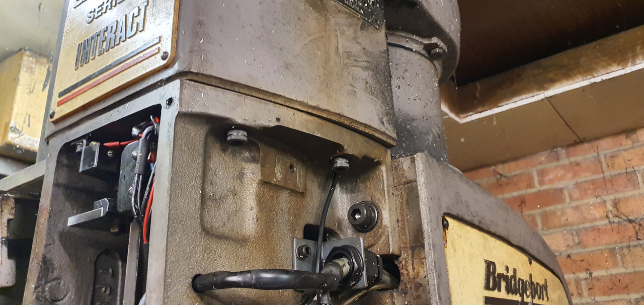

I have forgotten to take a picture of it, but the perspex cover which covers the Dial has what looks like an oiler mounted in it. A ballbearing fitted to it directly inline with a whole under it. Ill take a picture later when i get in.

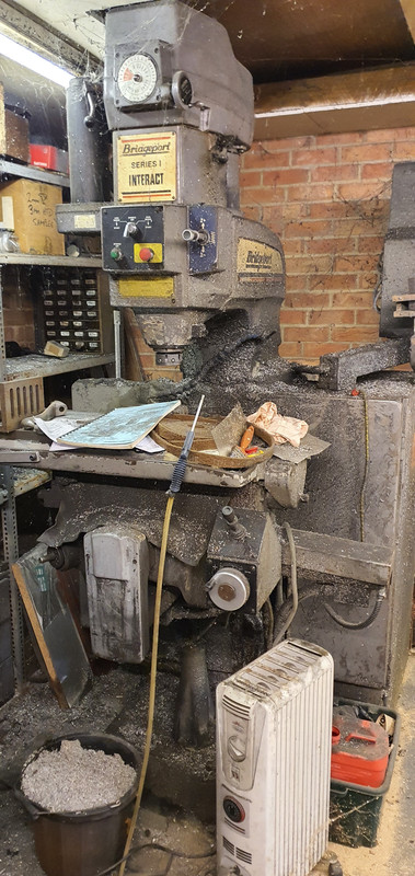

Ok so progress, i have mostly re-assembled the machine, nearly gave myself a hernia lifting the spindle / Pulley housing on, as well as the Z Axis Assembly. Engine Hoist couldnt get in there nor would go high enough to make it work so i had no choice but to lift by hand. Wasn't as bad as i imagined intially.

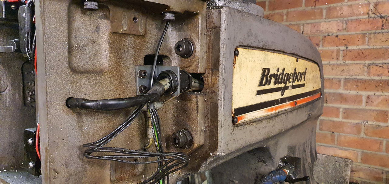

Z Axis Joystick was damaged, a wire had been pulled from the microswitch on the back, this probably happened during either of the moves. Luckily i had a bag of spare ones from my 3D Printers laying around so quickly replaced it.
