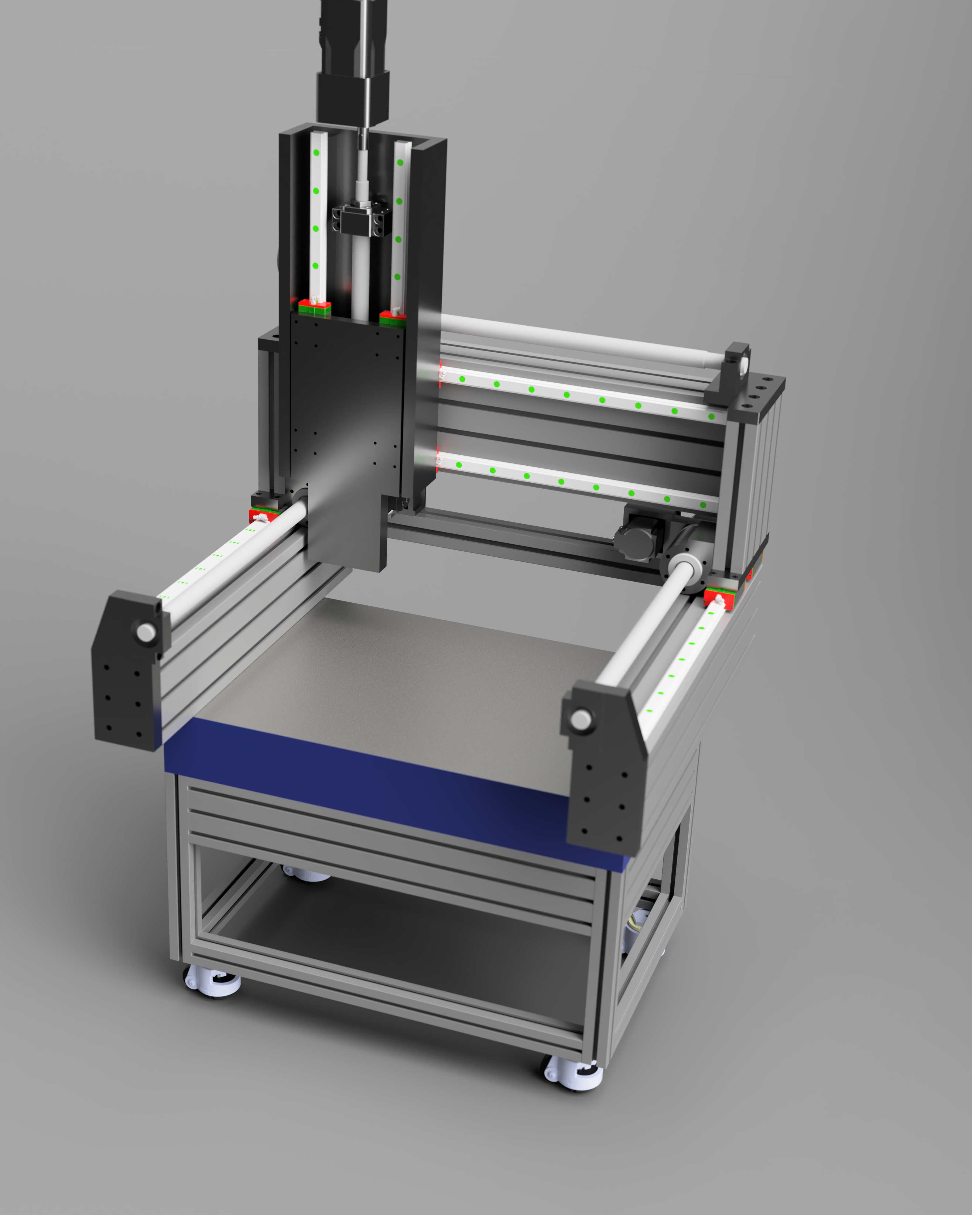

This is a fairly recent shot of the design, it's name is Kaiju.
As you can see, it is a gantry type design, using Aluminum extrusions, but before you go on a rant, these are very large and specialized beams, not typical of what is used outside of Japan. I'm not saying that they will allow me to cut steel, just that you should hold on to you comments until all the facts are known. Thanks.

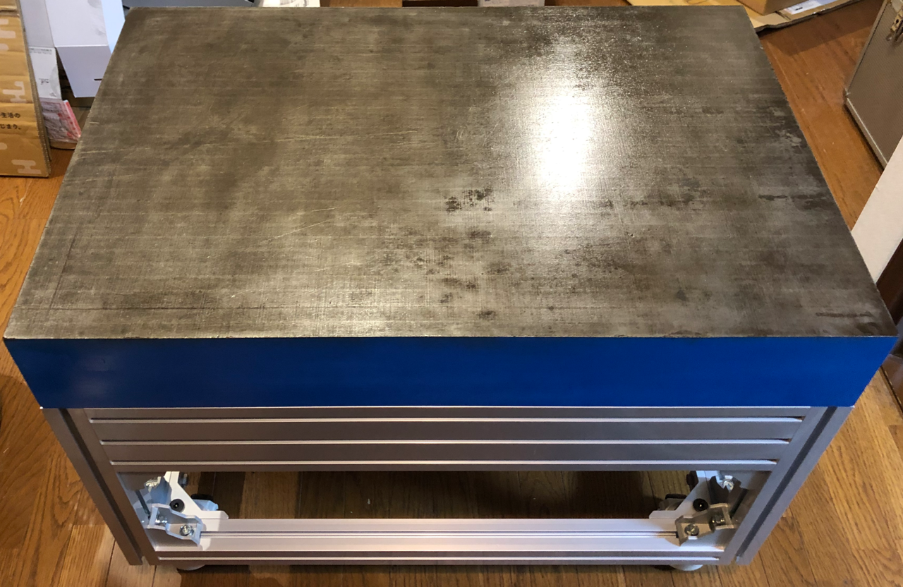

The base is an old 750mm x 500mm cast iron surface plate (sorry guys, we are metric over here and I've bought into it. Units of science.)

Well, you're not going to like my thoughts one bit, but here goes:
1) For the stationary Y rail mounts, use steel if at all possible. Yes, it's not as easy as using the box extrusion, but for a mill stiffness is everything.
Everything. Really.
2) Your X screw really should be down under the two rails, not above. You're asking for racking by having the drive high and the load low. Not good.
3) I can't see the detail of the X and Y ballscrew drive bearing anchors, just the stop-the-waggle end mounts. Make the drive side mounts as stiff as possible.
4) There is no 4.
5) This is where you tell me reasons why 1-3 aren't feasible.
Carry on...
Everything. Really.
Yes, understood. Sourcing or fabricating these structures in steel is extremely difficult over here, and I felt the aluminum would work well enough as a proof of concept if nothing else. If it is inadequate then doing an epoxy granite fill would be next, followed by strategic reenforcement with steel plate or replacement with a custom built (expensive) weldment. The fact is I can get the 150x100mm M10 extrusions delivered to my door in a day, so I'm willing to compromise for the sake of expediency. The main spar is 100x200mm and this is a pretty tiny working envelope of 500mm square.
Yes, I've contemplated putting it there as well as intuitively the lower area is applying load directly opposing the tooling forces. I just wasn't sure if the rails were strong enough to deal with the racking forces and I was making concessions to loads that didn't actually matter. I will continue to weigh options. This thing has to fit in a tiny space and I didn't want to give up the Z height, so again, lots of unfortunate compromises must be made, this is one I will keep pondering.
All the front bearings are proper NSK angular pairs, the end mounts are just floating deep grove. My ball screws are threaded on both sides, so I could theoretically pre-load them, but that will both increase the cost and reduce the travel. It is an option as a retrofit though. I figured these are already pretty beefy, having them constrained on both sides was overkill.
4) There is no 4.
Carry on...
LOL, 1 is the least feasible (although likely very easy if I was anywhere else in the world.) 2 is under serious reconsideration. 3 seems like premature optimization.

Japanese infrastructure is surprisingly basic, I visited a while back (Boeing work trip to Nagoya) outside of the city center the level of construction quality, wiring etc was really poor, given the size and general wealth of the economy I thought it would feel more developed. It was August and the lack of AC in the KHI office was rather noticeable :) It sounds like your property prices are a match for Oslo, my workshop is all down in France for a reason.
Anyway while the big plate is cool I don't think it will do much for the actual performance of the machine. (I suspect gantry flex etc is going to be a bigger issue than anything with the base. I would do a full frame from extrusions and use the plate as a worktable. If you do use the plate for a working surface of the mill you can just mill it aligned with the router and then drill and tap it for hold down fixtures but realistically you will want a spoil board for most things so the flatness of that plate isn't a big deal. As for the aluminum extrusion alignment off the plate, the flatness of the plate also doesn't matter that much as the extrusions are really not all that straight themselves. I would suggest ground ballscrews are seriously overkill but that isn't a problem :)
Another suggestions is that unless you access to a large milling machine the end cuts on those extrusions are possibly not going to be as straight and square as might be ideal, a configuration that allows of adjustment could make your life easier.
Building on top of the plate simplifies all the alignment procedures and helps lower the center of gravity. I don't expect it to contribute a lot to the structure, but it won't hurt either.
I have designed a couple routers but ended up buying parts for one in Germany Startseite | CNC-Alufrase the machine is a bit small but rather capable within its envelope. I run a 1.5kw Chinese water-cooled spindle and it will cut most anything. That design might give you some ideas. Do not underestimate the amount of Z travel you need, if anything I have found that to biggest limitation with my machine.
Luke
Japanese are fanatically precise with made to order industrial components like this, the parts will be square and within 0.1mm in my experience.
For Z travel, I've been super concerned about this. It may not be obvious from the picture, but the work envelope actually extends well past the front of the base plate. This will allow me to clamp things to the face or position workholding on a shelf below the surface of the baseplate.
I never knew that .1 mm was considered "fanatically precise". Are you sure you don't mean .01mm? Even that isn't what I would consider overly precise.
Have you considered filling the extrusion with epoxy granite?
Additionally, if you add some bolts through the extrusion into the void spaces, the granite will then have something to grip to.
For keeping chips off of the ballscrews, consider a series of nested cups, like think about the cover for the cylinder on an office chair
If you havent figured out a controller yet, consider the centroid Acorn or OAK. I dont know if you can get them over there, but I used an Acorn in my build and have had a good experience.
For maximum space savings, look into low profile vises and solutions from people like Mitee-Bite. Space is a premium, so dont take up half of it with a big vise if you dont have to
