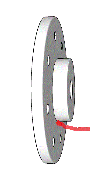

So I drained everything as best I could tell. I had noticed the rear spindle area hadn't drained after I drained the fluids which perplexed me at the time. I began filling it up with the appropriate fluids. When I went to fill the front spindle area, I noticed oil flowing out the front of the spindle, which it had not done previously. Upon closer examination I discovered it was coming from directly under the nose of the spindle, where it comes out of the flange. (see picture)
the red line is pointing to where it is leaking; it is not leaking from the bottom of the flange.
