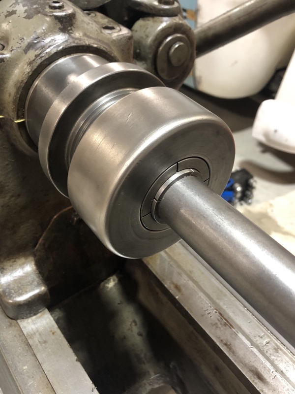

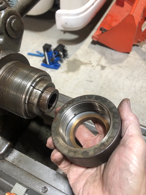

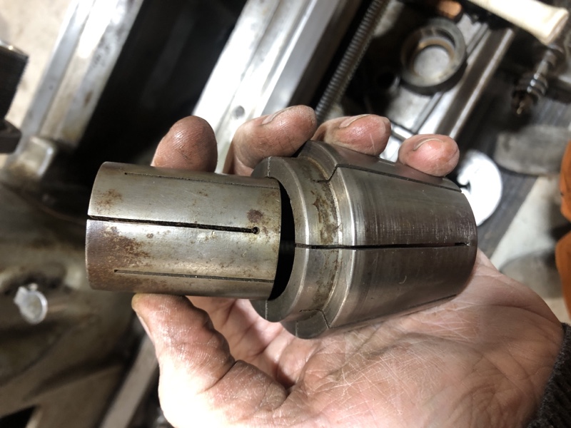

I have a shop-made collet system that came with my lathe that uses sleeves to adapt the tapered collet to smaller sizes. It works well, providing a tight grip right to the opening.
Before cleanup:
After cleanup, holding a 1-1/4” bar (the tapered collet is 1-1/2”):
Rick “who will make sleeves as needed” Denney
