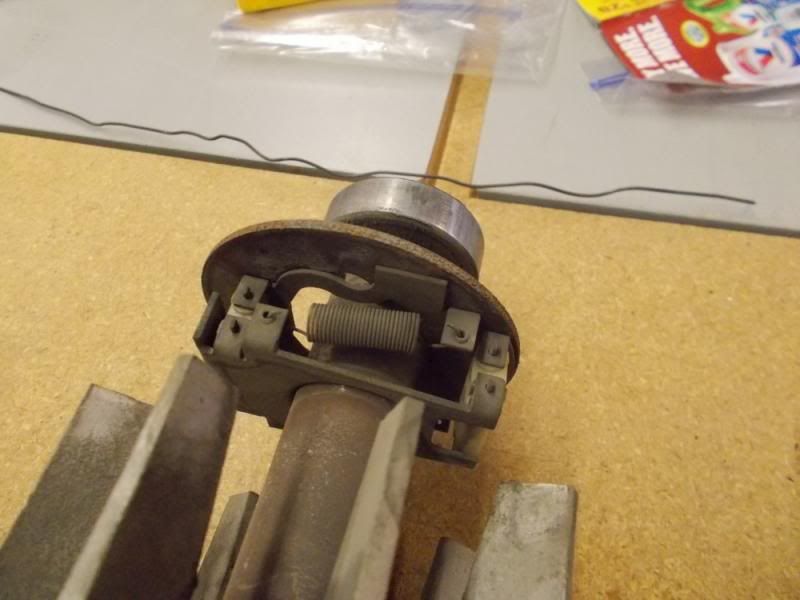

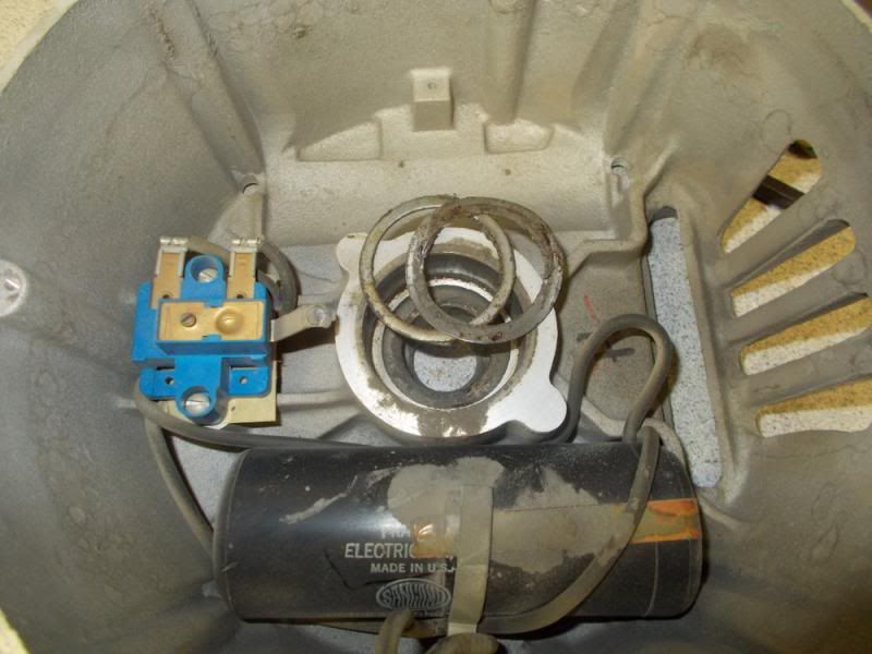

I put the armature in my lathe and verified that that part of the switching mechanism is working. However, I did find that the actual switch is acting flakey. I cleaned it up the best i could without taking it apart. It did improve, but I am not convinced. I might check around with a local re-builder for a replacement.
Here is the motor nameplate
For those who have never seen inside.
Switch is on the left.
Here is the mechanism on the armature.

If you have the space, the way to clean these contacts is to cut a strip of about 400 grit wet or dry paper that is twice as wide as you need and fold it lengthwise. With the contacts open, slide the strip in between, then hold them closed and pull it out. Repeat as needed. That way you are forming parallel mating surfaces. I said that in another thread a while back and got the usual flak about conducting grit and all that, but I have been doing it since 1959 with no problems. Just be sure to blow the dust out.

10-4. I had already done as you suggested, but not sure what grit I used. Just something I had laying around.
Got it all put back together last night and it works just fine with the original parts. So I went ahead and shot a coat of paint on it.
I had made an offer on an ebay capacitor, but the guy declined. And i am impatient and as mentioned previously, cheap. Once I determined it was the switch, I did not ahve many reservations about re-using the cap.
I am not surprised at the switch. Previous life of the lathe was spent in an extremely dusty shop at the limestone plant at my work. When the lathe was put into storage several years ago, someone did tape up most of the vents in the motor, but it still sat for a long time.
